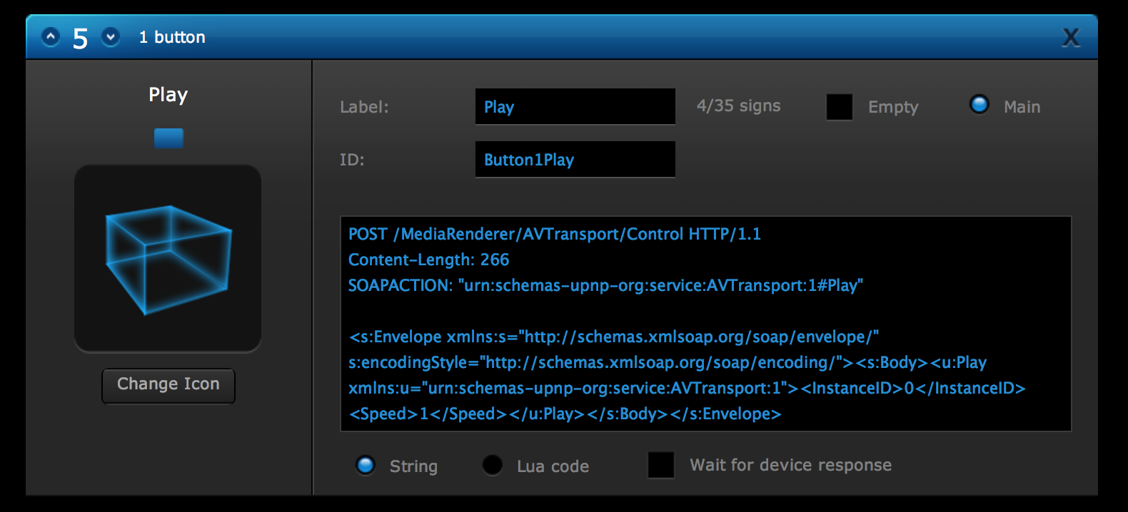

Hi all,
For those who are interested I made a Virtual Device based on the new LUA feature (inspired on lua code for MIOS) which can control a sonos device. It uses curl but will change it when the http api is documented. Change the IP address accruing to your needs.
EDIT: Added additional comments from other post which I posted in this thread.
