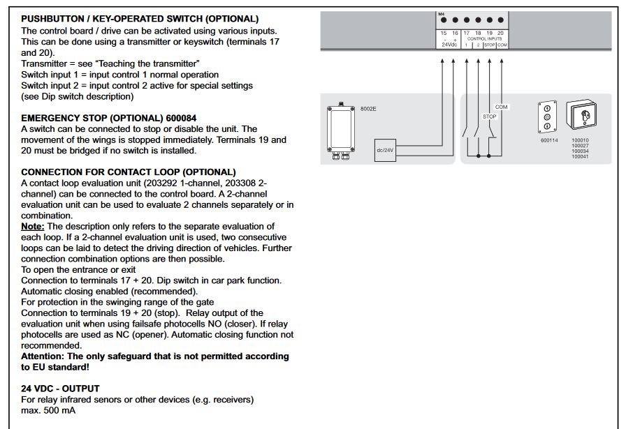

I am trying to work out how / if i can use a Fibaro Dual Relay Switch to open and close my gates which are controlled by a LiftMaster CB11 control board.
The control board allows the connection of a switch to open / close the gates so i'm hoping the relay can be used as that switch. Below are the details of how the gate control board and relay switch works and i was wondering if anyone could point me in the right direction of what to connect where.
