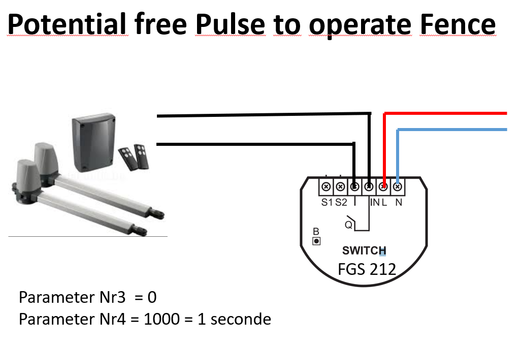

Need a pulse to operate a gate motor: which Fibaro module?
December 14, 2017
The motor of the outdoor gate need a pulse to operate (on/off/on not a constant on state). Which fibaro module/settings is best used to realise this? Can the pulse lenght be set?
