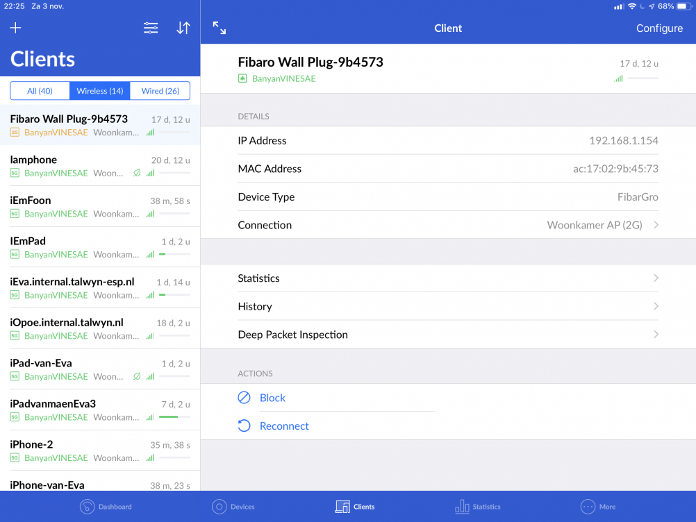

  • Alas.
    /monthly_2018_11/DDF8FE54-1E0D-4A03-ABBA-E3118F88D5AC.jpeg.c220ab95882dddadab7503236bb65284.jpeg" alt="DDF8FE54-1E0D-4A03-ABBA-E3118F88D5AC.jpeg.c220ab95882dddadab7503236bb65284.jpeg" />
    Share this post
    Link to post
    Happened to me too, can you see if it is still on Wifi network?
    Share this post
    Link to post

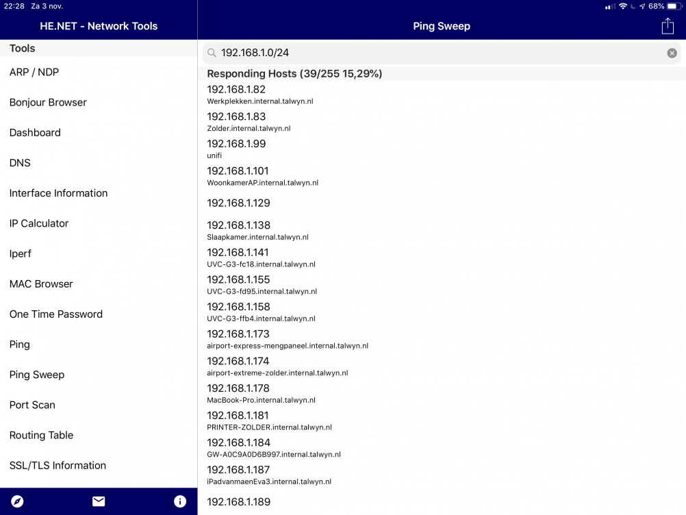

  • It looks like it is still on the network but it does not respond to ping nor is it visible in a bonjour browser.

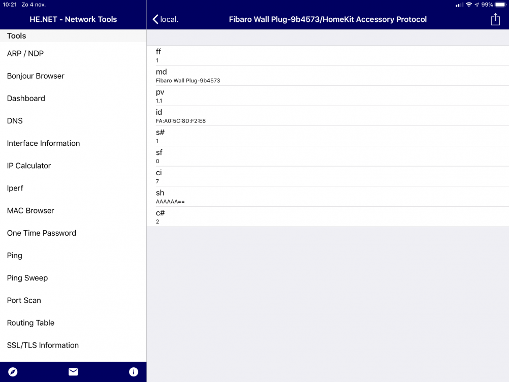

  • Indeed, after resetting it responds to ping again, and bonjour HAP is visible again:
