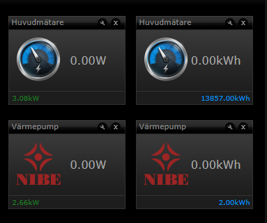

Hi,   I have an issue with a device for which the HC2 does not display its values properly in the  UI.    The device in question is a power/energy meter built on the z-uno device.   As seen in the attached screen shot, the power and energy values are correctly written out in green and blue in the footer, but the main value, in big white letters, always shows "0.00".   I have other devices (for instance the Fibaro powerplug) for which the power values are c
