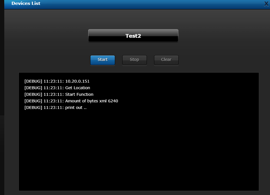

    this is what I will get nothing of the XML is showing up. but i know that i get the XMl because it was possible to see how many bytes it has
    (when i try to use the locInfo Debug  nothing is printed out.)
    /monthly_2019_02/image.png.61624fa3effb5eb46703904d9368ac14.png" />

    Seems to be an issue with your http requests - or the way that you have structured the code? Do you have the code in the main loop or a button? Who prints the "Get Location" and "Start Function" logs? ...and why do it in a VD?
    11 minutes ago, pepijn said:
    move the debug before the conversion as we never see the log otherwise. I expect there are some xml headers,

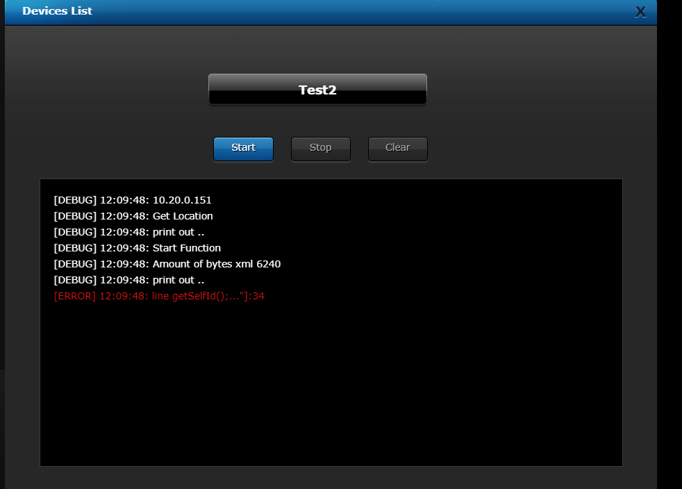

    Oke this is what i have right now . but it gives me a error on line 33  wich is
    Edited by pepijn
    Link to comment
    What kind of error? It still seems like what you get is not what you had in your first example.
    Can you do this to print the xml data?
