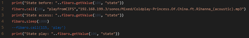

14 hours ago, tinman said:
-- play some mp3 from network share fibaro.call(SonosQAID, "playFromCIFS","192.168.199.33/2Pac/Me and My Girlfriend.mp3")
Test scene delivers no sound
State is at all positions STOPPED
While file://///192.168.1.3/d/SonosGeluiden/Deurbel.mp3 in browser delivers sound (in PC of course, not in Sonos).

and you have added that path to sonos media lib and can play that file from Sonos App?
Link to comment

no idea, check if you can play from Sonos App. It works for me, and it does deliver status
/monthly_2020_09/image.png.0fdfaa91c7a339d11157cb5748bc6194.png" />
BTw, you don't need any "play" extra, playFromCIFS and playFromUri starts it automatically.
EDIT: some hint for other with similar issues, name != IP, so try both.
Edited by tinman
Link to comment
