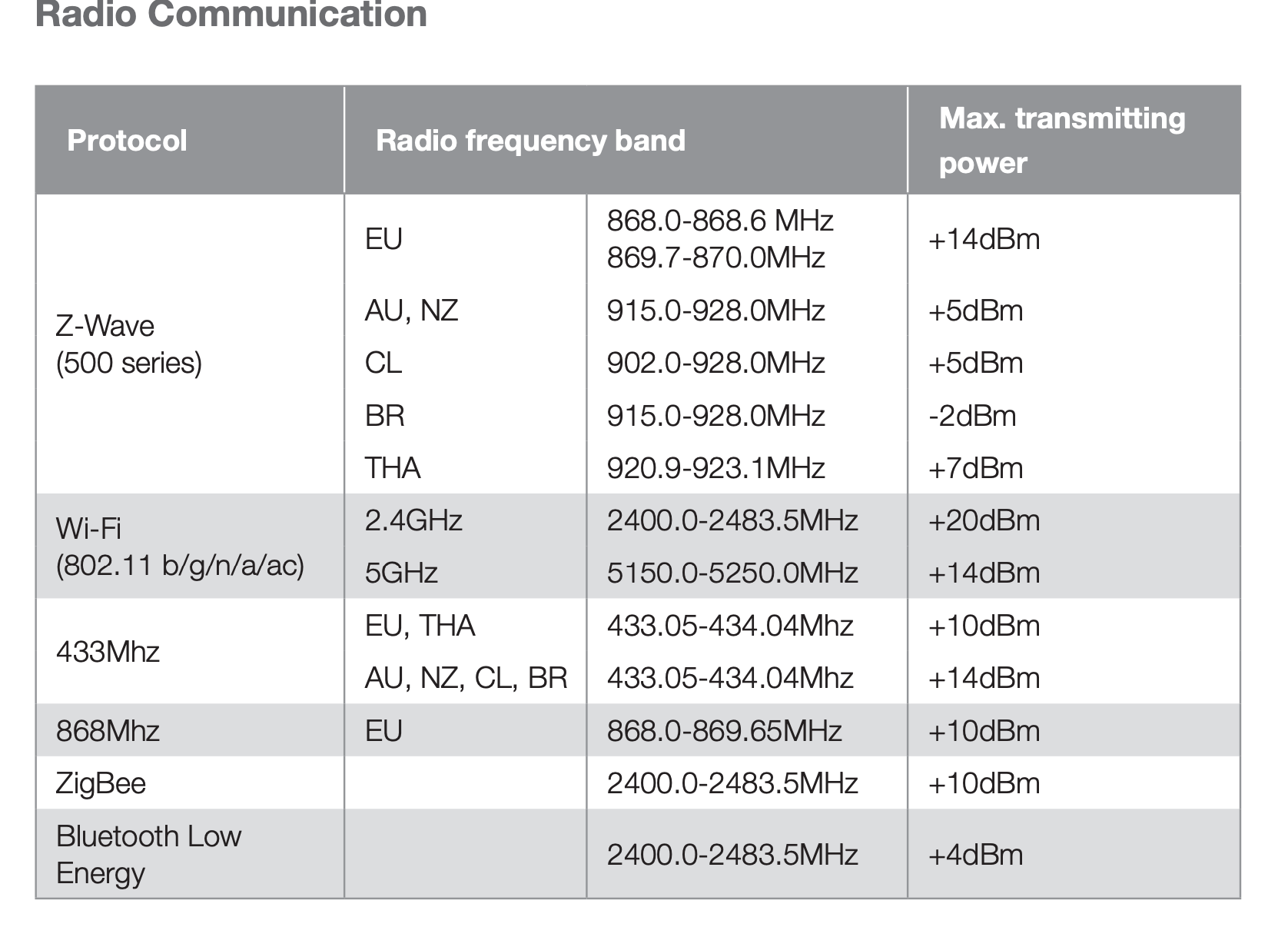

In reading the manual for the Home Control 3, I notice that the US radio frequency band was missing in this table, whereas it appears in the HC2 manual (908.42/908.40 MHz US).  Does this imply it doesn't work in the US?  I don't how how the freq. switching is implemented.  I was hoping to replace my HCL with this in the near future.     Please login or register to see this attachment.
