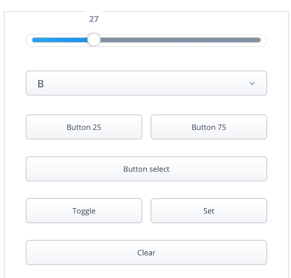

  • Supports simple web UI to test QuickApp buttons/sliders

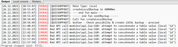

Here we se the system log (|SYS  |) that the QA is loading and then the log that it's running.
The first is when the QA code is loaded and all functions are defined. Also if you do something on top-level, outside functions it will run here. In the example the QA does a
on top-level of the QA so that is executed when loading.
Then, if the QA is successfully loaded, it will be "started, meaning that the function QuickApp:onInit() will be called if it's defined. That's the second SYS log. It's good to pay notice to this.
  • If you get an error before Loading it typically means that you have a syntactic error in the QA code - non-valid Lua code.
  • If you get an error after Loading but before Starting it's something on top-level that is run, outside of function QuickApp:onInit()
  • If you get an error after Starting, well, then it's just something wrong with your code when it runs.
A run-time error will look like:
This tells us that the error was in the QA with id 1002 (unless you have changed __TAG)
The QA file is 'main'. A QA can consist of many files and this gives us the clue in what file the error was. If you only have one file, its name is 'main'.
Then it tells us that is was line 5 where the error occurred ([string "temp/main_16546.lua"]:5:) and then that we tried to call a global variable 'foo'
 that didn't have a value (a function)
So, in the main file look for a foo() call on line 5 - that's the error...

  • An emulated QA can specify a Web UI that tries to mimic the UI you get when you design the QA on the HC3.
    Only buttons, sliders and labels are supported.
    To define the UI you add QA directives
    in the code.
    Resulting in the UI

    The output will look something like:
    Note first that there is no connection to the HC3 - we are missing user,  password, and IP for the HC3.
    Secondly, note the WebAPI address. 192.168.1.18 is my machine, your IP address may be different. The port is 8976.
