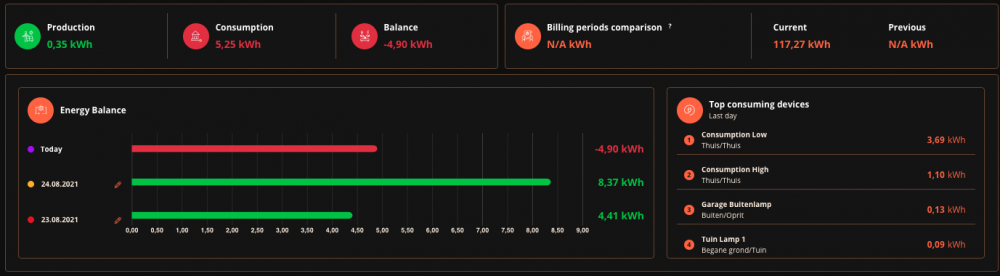

Further testing the new Energy Panel and putting values to it, I see some difference
If I compare the the Consumption value (5.25 kWh) with my other calculations, there is some mismatch. I put the total consumption and total production in the Energy Panel. But all z-wave power measuring send by default there energy usage also to the Energy Panel.
So I have to make a choice, reduce the Consumption of the P1 Monitor with the energy usage of all z-wave power devices before updating the Energy Panel, or turn off the z-wave power devices updating the Energy Panel.
