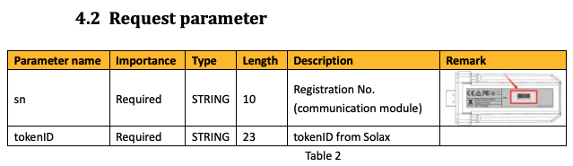

See API documentation on
User can get a specific range of information through the granted tokenID. Please obtain your tokenID on the API page of Solaxcloud for free.
The tokenID can be used to obtain real-time data of your inverter system. The obtain frequency need to be lower than 10 times/min and 10,000 times/day.

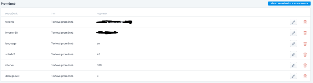

Variables (mandatory):
