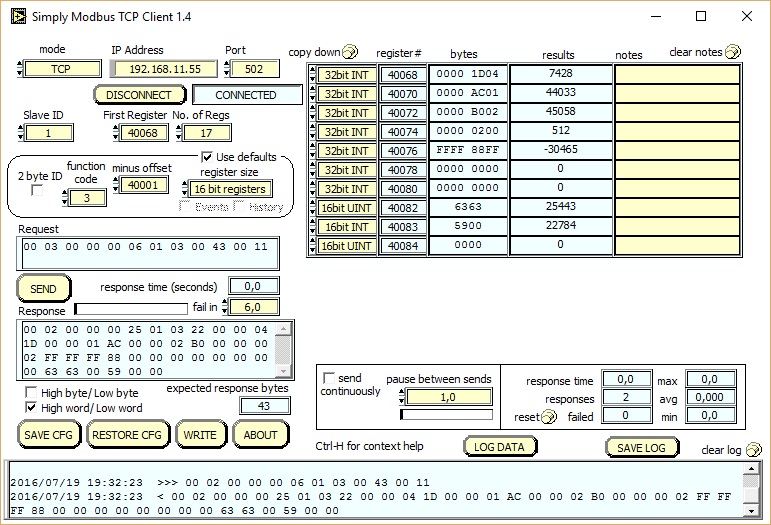

Hi   I have a project at home, where I want to read data from my floor heating controlsystem and heating system. Those systems have Modbus RTU, and I have a gateway which convert it to Modbus TCP-IP.   Is there any way to read data from modbus in HC2? If so, how could I get the information from the modbus register? Can look like: Register 50006, Temperature, 16bit value. The gateway can be set to "Transparent modbus/tcp to modbus/rtu", i.e to reach the information I first need to access 19
