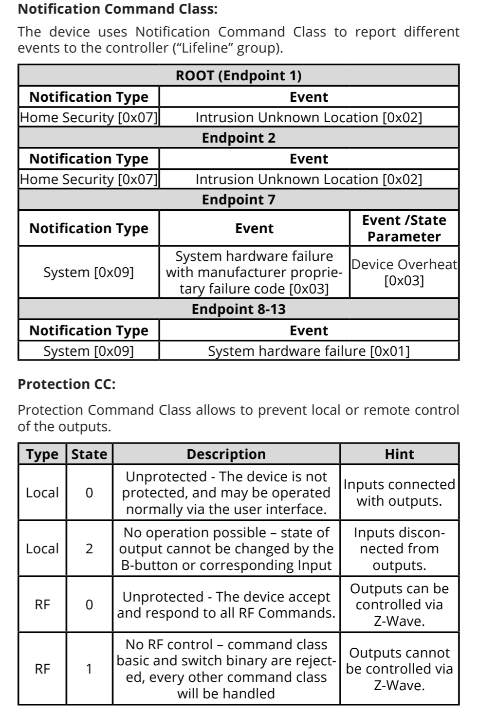

268/5000       Hi there I have a question about the smart implant. Is that correct that I cannot activate the end coupling to the outputs in digital mode of IN1 and IN2? With my HC3 I did not know whether the option was offered. Greetings from the Sauerland
