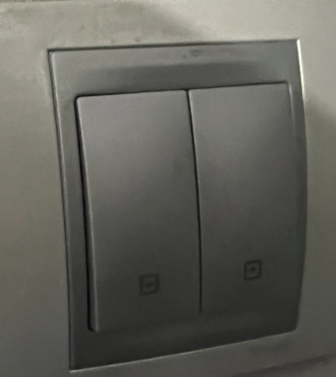

Hello,   I am using Roller Shutter 3 FGR-223 without any problems since 2 years, and suddenly, two problems: - question mark on the icon after upgrading to 5.120.10 --> I understood that it's linked to the update and it should be solved with a future release Please login or register to see this link. . - the status report is not sent anymore to the app: if I move the blind with the physical button, the status is not reported back to the app   I initially thought that it w
