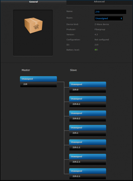

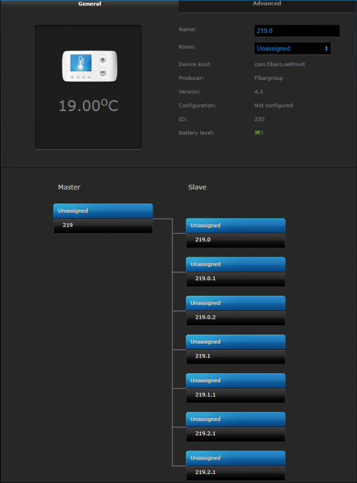

My first updated TRV had an external sensor connected.
After update I've got the below "master-slave" devices and of course is not working properly.
It is presenting FW 4.3 and I cannot retry the update.
The other two devices I have updated were without external sensor and the update worked without any problem.
Does anyone know what I can do for the failed one?
Regards
/monthly_2018_03/image.thumb.png.474f00a3b1a3cf790682b475fd5b156c.png" data-fileid="24809" />
Hm, it will be good if others can confirm it also.
As, excluding the external sensor before update is much easy step, compared to the headaches one may go in case of update failure.
I see no option than exclude/include the device from the HC.
It will be indeed strange if the device still reports such slaves after clean inclusion.
Are the duplicate Slaves with same IDs in the system? If so, it may be some bug in the HC firmware itself (even not, still a bug :)
Already did it.
Exclude it. Reset it. Include it (without external sensor)
Same slaves reported. No Duplicate IDs.
How it can be a HC FW probelm as long as other TRV devices are OK?
Edited by adyboss
Really strange.
In my opinion problems may be two for the faulty device:
1. TRV firmware is broken, and report wrongly to controller upon z-wave interview. I think it is less possible scenario, if possible at all.
2. HC bug, adding duplicate slaves, cant guess why. Probably a reboot may make it "think different". Cant guess any other options you might have in this situation.
I know it is not funny, but on the other hand, you are lucky, you've gоt two TRVs at the price of one :)
