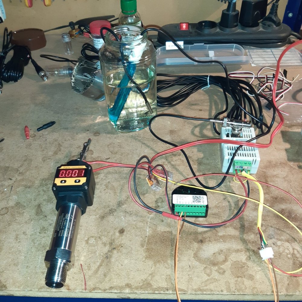

    OK After some time Sensor modules came ....
    Anyone interested is this from Ali Express
    Must Order the 1-10v output
    Connecting them to the RGBW sensor i finally can see the Ph ORP and Filter Pressure inside the Fibaro Interface...

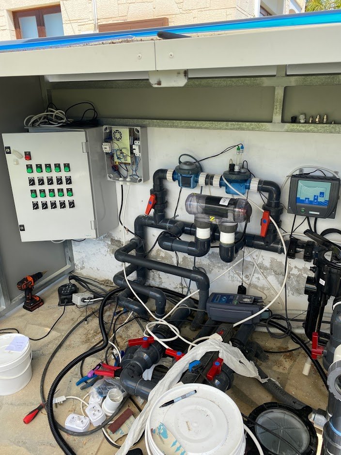

    What i am trying to do next is to Build my own Salt Chlorinator and control it via the HC2

    Yes That is for the Pool.
    I get the Ph Values and ORP values from the modules i bought from Aliexpress.
    The output of the modules go into the RGB module which is configured as analog inputs ...
    With the PH reading i am controlling a dosing pump which feeds HCL into the pool
    With the ORP reading i am controlling a custom Power supply which is connected to a Zodiac Cell and produces chlorine
    I went with the Zodiac Tri Large which makes about 35gr/Hr Chlorine ....
    This cell needs about 17Volts and 7.6A in a pool with 7000ppm Salt concentration .....
    i know its a bit salty ... :)
    With the custom Power supply i had a challenge of having to reverse polarity going to the cell in order to have cleaning function ...
    i decided to use a simple mechanical timer and a conductor that reverses the polarity every 3 hours for 3 minutes ...
    i could have done that with a fibaro lua ( calculate working hours of cell and after 3 hours turn on one of my modules for 3 minutes ... as long as the pool pump is on !! ) the output of that module would drive the auxiliary conductor coil and thus reversing the polarity )
    but since my coding is very limited i went with this route
    With the pressure sensor i get reading of the pressure inside sand filter and when pressure rises above 0.9 Bar i get a notification to backwash my filter
