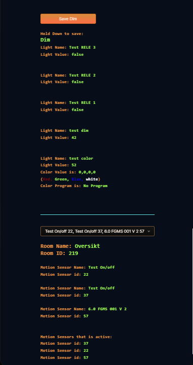

Just want to share my Easy light controller:
Can now also be downloaded in the marketplace :D

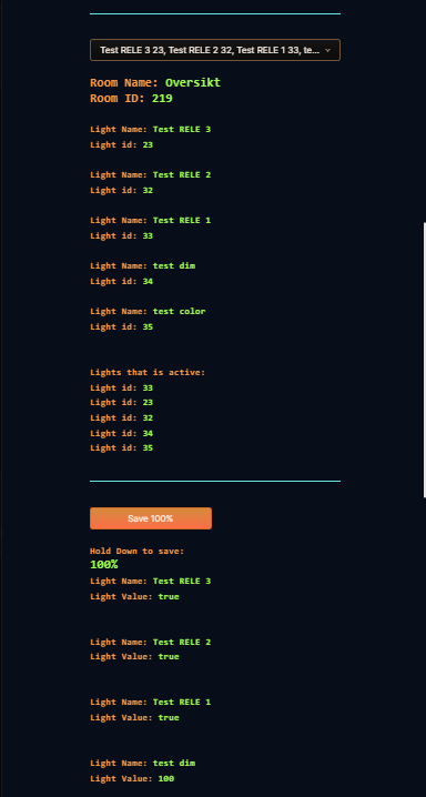

It is a fast way to get Motion Lights up and going. Just upload it to the room and choose from the dropdown menu.
It is alot like my other Room Light controller, just without the profile handling for small rooms.
Choose what should happen on/off pir events
Choose the lights and sensor to use from the room the controller is in.
(can also use the Qvar to the room you want to controll to have the controller in an other room)
You can also store 2 custom Scenes (rename the scenes in the Qvars scene1 and scene 2 - standard 100% and Dim)
To save the scenes just hold down the Save 100% or Save Dim button for 2sec when the lights are set as you want them to be.
Scenes also support rgbw2 controller programs and colors
Labels can be changed colors with the Qvars color1,color2..
(might add support for theme colors)

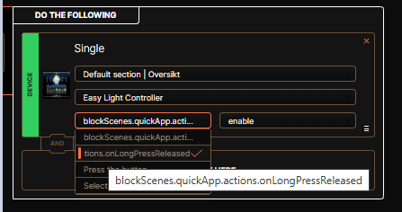

added enable/disable motion to use in scenes (use the onLongPressReleased enable/disable)   (if you want to disable by timer/sunset/sunrise)

    in the last release I forgot to update the "onlongpresreleased" to save1 and save2:  (19.12.24)
    Sorry for the inconvinient.
    updated in the first post :)
