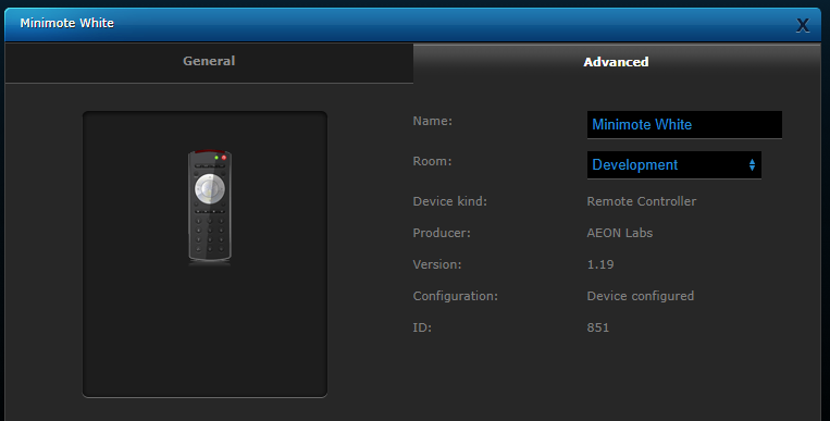

  1. Hi, I dusted off my minimote and can't seem to get it to trigger from a button press HC2 running 4.140 It included okay It created 8 parameters (241 to 248), I left these at factory default I used my usual CentralSceneEvent code --[[ %% properties %% events 851 CentralSceneEvent %% globals --]] local jT = json.decode(fibaro:getGlobalValue("HomeTable")) if (fibaro:countScenes()>2) then fibaro:abort() end local pressSource = fibaro:getSourceTrigger()["event"]["data"] fibaro:debug(json.encode(pressSource)) -- Button 1 to 4 when button is PRESSED once if (tostring(pressSource["keyAttribute"]) == "Pressed") then if (tostring(pressSource["keyId"]) == "1") then fibaro:debug("1 pressed") elseif (tostring(pressSource["keyId"]) == "2") then fibaro:debug("2 pressed") elseif (tostring(pressSource["keyId"]) == "3") then fibaro:debug("3 pressed") elseif (tostring(pressSource["keyId"]) == "4") then fibaro:debug("4 pressed") end end When I press one of the remote buttons the Web UI displays 'Scene Activation !' or 'Scene Activation 2' etc depending on the button pressed Do I need to adjust any of the parameters or could somebody that has it working post their code Thanks
