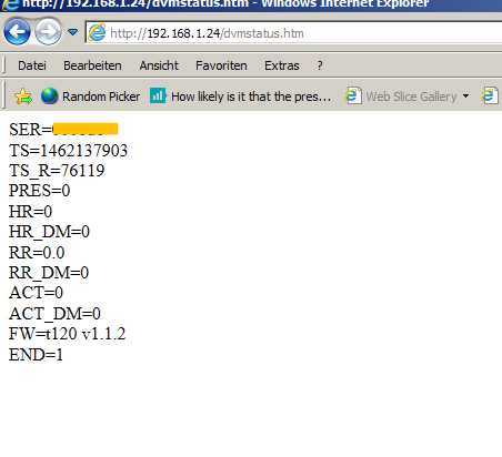

  1. Dear Fibaro experts, I own an Emfit sleep tracker. The device has an own http server on part 80 in my local network. The system is telling me once I am in my bed or once I leave the bed. It tells me as well in what sleep phase I am. What I would like to do is to trigger Fibaro events based on parameters of the sleep tracker. The company offers the core data on the http server (see picture): PRES Presence SER Serial number of the device, 6 HEX characters (0..9,a..f) TS Timestamp, UNIX time (seconds). TS_R Relative timestamp, seconds from device boot. HR Heart rate in beats per minute. RR Respiratory rate, per minute. ACT Activity value. (unitless) Question: Can you please help a unexperienced Fibaro fan and share how I could readout the http local server to translate e.g. the ACT parameter into a Fibaro variable? Would be great! I appreciate your help and support. Cheers, Alex
