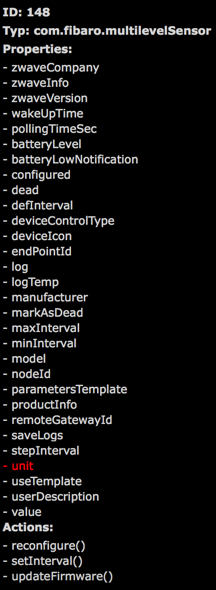

  1. Hi I have the NorthQ NQ-9021 energy meter. I´m about to make an energy-to-power routine but I need to increase the data rate from the NQ-9010 so my time intervall don´t get too long. My problem is that I now know how to set the NQ-9021 in realtime mode, but in order to get data the HC2 need to poll the NQ-9021. The global HC2 device polling interval is 125s, but I don´t think its a good idea to reduce this value. I cannot see any way to set this value individually for a single device. I need a way to poll the NQ-9021 individually, every 10s or 20s, (using LUA?). Can someone please help me with this? Attached is the property and action list for the NQ-9021.
