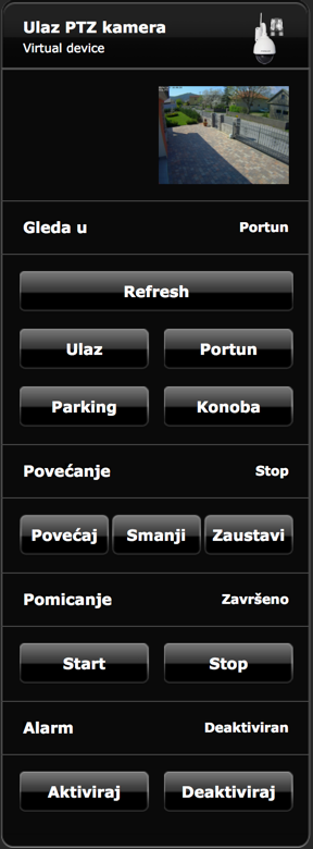

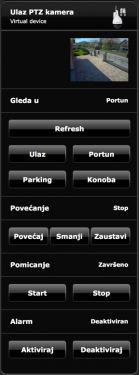

  1. This is what I get on my HC web GUI interface: And this is how I get it: local selfId = fibaro:getSelfId(); local cameraImage = "<img src='http://192.168.xxx.xxx:88/cgi-bin/CGIProxy.fcgi?cmd=snapPicture2&usr=USER&pwd=PASSWORD' alt='Cam terrace1' style='width:120;height:90px;'>" fibaro:call(selfId, "setProperty", "ui.Label5.value", cameraImage); local cameraImage = "<img src='http://192.168.xxx.xxx:88/cgi-bin/CGIProxy.fcgi?cmd=snapPicture2&usr=USER&pwd=PASSWORD' alt='Cam terrace' style='width:120;height:90px;'>" fibaro:call(selfId, "setProperty", "ui.Label5.value", cameraImage); fibaro:debug("Camera image refreshed") fibaro:sleep(3000) Since VD label is not really updated if content is not changed (you probably didn't know or noticed that ) to refresh picture you have to change content so I changed caption for picture otherwise picture is not refreshed! Unfortunately, picture is not showed on mobile applications since they are not using html coding. So to achieve that is either not possible or need some other coding. Greater gurus than me might know that. Interesting? Yes Useful? maybe Enjoying? Definitely YES!
