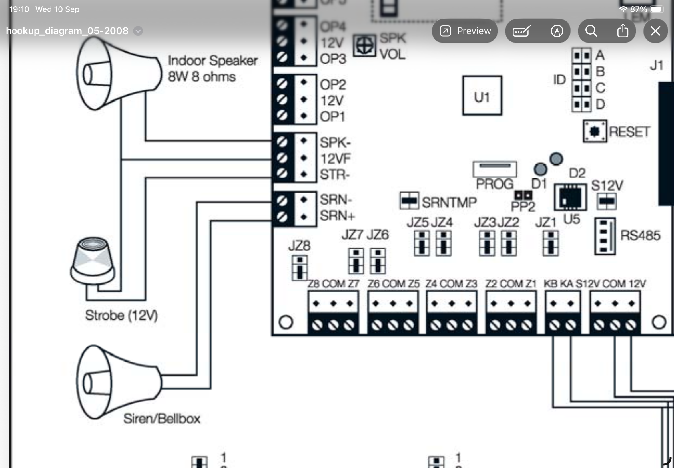

  1. Hi Guys, I purchased a smart implant for a small project on a Comfort CM9001-ULT alarm panel. I want the smart implant to recognise when the strobe is activated. The implant has 0/12V Aux supplying the implant with power, so I was hoping to use IN1 for the 12V output for the siren. This should revert alarm state back to the system. Seems that my panel is only connected to STR- (strobe neg) as this is the switching terminal. The 12VF isn’t connected and I assume is linked at the siren box itself from another 12V supply. The strobe functions, so I guess its wired correctly. The idea is that on seeing the strobe activation a signal would be sent to strobe my LIFX downlighters as well, giving a more impactful visual effect to deter intruders. The implant is connected to the AUX 12V/COM for power and is working and connected to the system. The only issue I have is the connections for the strobe. Anyone have any ideas on how this should be connected, so as to see the change in state whe the strobe activates?
