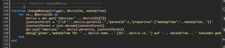

  1. Hi there, i have a Problem with an old scene. Since one of the last updates, i get this error: [DEBUG] 21:56:06: --------------------START-------------------------------- [DEBUG] 21:56:06: --------- Danfoss WakeUp powered by mkshb.de [DEBUG] 21:56:06: ----------------------------------------------------------- [DEBUG] 21:56:06: Trigger durch manuelles Starten [DEBUG] 21:56:07: -------------- Calculate and Set WakeUpTime ------------- [DEBUG] 21:56:07: Zieltemperatur: 17 [DEBUG] 21:56:07: Aussentemperatur: 20.5 [DEBUG] 21:56:07: Es ist Sommer verwende entsprechende Werte [DEBUG] 21:56:07: 2019-06-17 21:56:07.791861 [ fatal] Unknown exception: /opt/fibaro/scenes/27.lua:147: attempt to concatenate local 'wakeUpTime' (a nil value) Here is the code: --[[ %% autostart %% properties %% globals PresentState SleepState --]] ----------------------------------------------- -- mkshb.de - Danfoss WakeUpTime ----------------------------------------------- --[[ Change wakeUp Intervall for Danfoss Trigger: globale Variablen TimeOfDay, PresentState, SleepState Quelle: https://www.mkshb.de/wakeup-intervall-per-lua-anpassen/ --]] --------------------------------------------------- --------- Schleifenschutz ------------------------- if (fibaro:countScenes()>2) then fibaro:debug('Kill the second scene!'); fibaro:abort(); end -- Konfiguration ----------------------------------------------- --Allgemein local advdebug = true local scheduler = true local runMinute = 5 --Temperaturen -- local outdoorTemp = {208,'Temperature'} -- Aussentemperatur von Yahoo-Wetter local outdoorTemp = {3,'Temperature'} -- Aussentemperatur von YR-Weather local indoorTemp = {153,'targetLevel'} -- Zielzemperatur vom Thermostat Wohnzimmer Kr1 -- Zeiten local basisSeconds = 100 local minSeconds = 90 local winterMonth = {1,2,3,10,11,12} -- Intervallkonfiguration local presentVar = 'PresentState' local presentHomeVar = {'Home','900','calc'} local presentAwayVar = {'Away','900','900'} local presentHolidayVar = {'Holiday','1800','1800'} local version = 'v1.1.1' --------- Farbiges Debug -------------------------- --------------------------------------------------- debug = function ( color, message ) if (advdebug) then fibaro:debug(string.format('<%s style="color:%s;">%s</%s>', "span", color, message, "span")); end end --------- Function round -------------------------- --------------------------------------------------- function round(num, numDecimalPlaces) return tonumber(string.format("%." .. (numDecimalPlaces or 0) .. "f", num)) end --------------------------------------------------- ------------- Funktion checkSeason ---------------- function checkSeason(tab, val) for index, value in ipairs (tab) do if value == val then return true end end return false end --------- Function calculateTime ------------------ --------------------------------------------------- function calculateTime(trigger, Outdoor, Indoor) debug('blue','-------------- Calculate and Set WakeUpTime -------------') -- Ermittlung der aktuellen Temperaturen indoorTempValue = fibaro:getValue(indoorTemp[1], indoorTemp[2]) outdoorTempValue = fibaro:getValue(outdoorTemp[1], outdoorTemp[2]) --Debug Ausgabe debug('green','Zieltemperatur: '..indoorTempValue) debug('green','Aussentemperatur: '..outdoorTempValue) --Berechnung wakeUpTime wakeUpTimeCalc = round(basisSeconds + (indoorTempValue * outdoorTempValue),0) if wakeUpTimeCalc < basisSeconds then wakeUpTimeCalc = minSeconds else wakeUpTimeCalc = wakeUpTimeCalc end --Bestimmung Sommer / Winter if checkSeason(winterMonth, tonumber(os.date('%m'))) then debug('green','Es ist Winter verwende entsprechende Werte') season = 3 else debug('green','Es ist Sommer verwende entsprechende Werte') season = 2 end -- WakeUp nach PresentState setzen if fibaro:getGlobal(presentVar) == presentHomeVar[1] then if presentHomeVar[season] ~= "calc" then return presentHomeVar[season] else return wakeUpTimeCalc end elseif fibaro:getGlobal(presentVar) == presentAwayVar[1] then if presentAwayVar[season] ~= "calc" then return presentAwayVar[season] else return wakeUpTimeCalc end elseif fibaro:getGlobal(presentVar) == presentHolidayVar[1] then if presentHolidayVar[season] ~= "calc" then return presentHolidayVar[season] else return wakeUpTimeCalc end end end --------- Function findDanfoss -------------------- --------------------------------------------------- function findDanfoss() allDevices = api.get('/devices') danfossDevices = {} for i=1, #allDevices do if allDevices[i].type == "com.fibaro.thermostatDanfoss" and allDevices[i].baseType == "com.fibaro.hvac" and allDevices[i].properties.zwaveCompany == "Danfoss" then table.insert(danfossDevices, allDevices[i].id) end end return danfossDevices end --------- Function changeWakeup ------------------- --------------------------------------------------- function changeWakeup(trigger, deviceIDs, wakeUpTime) for i=1, #deviceIDs do device = api.get('/devices/' .. deviceIDs[i]) jsontextParent = '{"id":'..device.parentId..',"parentId":1,"properties":{"wakeUpTime":'..wakeUpTime..'}}' jsontextParent = json.decode(jsontextParent) api.put('/devices/' .. device.parentId, jsontextParent) debug('green','wakeUpTime für ' .. device.name ..' (ID:'..device.id..') auf ' .. wakeUpTime .. ' Sekunden geändert') end end --------------------------------------------------- ------------- Timer Function ---------------------- function timerFunction() minutes = os.date("%M") if tonumber(minutes) % runMinute == 0 then debug('green','Trigger durch Scheduler') changeWakeup('Autostart', findDanfoss(), calculateTime('Autostart',outdoorTemp,indoorTemp)) end setTimeout(timerFunction, 60*1000) end --------------------------------------------------- ------------- START ----------------------------- debug('green','--------------------START--------------------------------') debug('green','--------- Danfoss WakeUp powered by mkshb.de') debug('green','-----------------------------------------------------------') sourceTrigger = fibaro:getSourceTrigger() if sourceTrigger["type"] == "autostart" then if scheduler then debug('yellow','Scheduler gestartet.') timerFunction() else debug('red','Scheduler ist deaktiviert. Start durch globale Variablen') end elseif sourceTrigger["type"] == "global" then debug('green','Trigger durch globale Variable: '..sourceTrigger["name"]) changeWakeup(sourceTrigger["name"], findDanfoss(), calculateTime(sourceTrigger["name"],outdoorTemp,indoorTemp)) elseif sourceTrigger["type"] == "other" then -- Manuell gestartet debug('green','Trigger durch manuelles Starten') changeWakeup('Other', findDanfoss(), calculateTime('Other',outdoorTemp,indoorTemp)) end Is there anybody who can help me? Thanks a Lot! regards Rik
