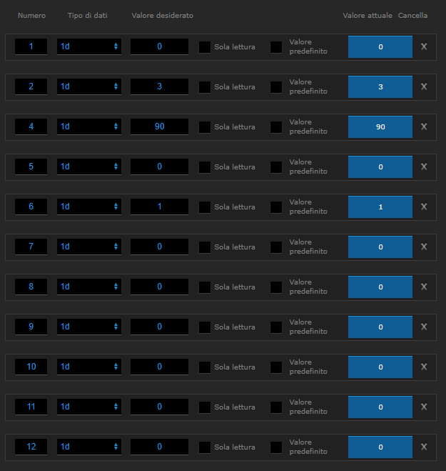

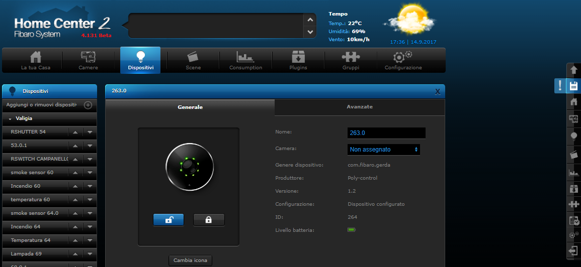

  1. Good evening, i write because recently my home automation has been faced with a problem that we have not been able to solve. On all of our installations based on HC2 fibaro gateway we are unable to set the Danalock V2 degrees rotation, which runs smoothly before. the version of firmware og HC2 is 4+ It's a very serious problem and we should fix it as soon as possible. I followed your directions but the problems continue to persist. A big problem is that when parameter 4 in the detail of the rotation is in the detail of the rotation, it is as if it is not read properly, ie if I insert as value 1 or 36 the movement of the lock is always a measure around it to 10 degrees. Also, via Fibaro HC2 interface, detailing without modifying parameters, the control panel shows that the device has been modified and requests to save the changes. I'm almost desperate, we have 5 Danalock installed and we can not complete 2 laps at the lock.
