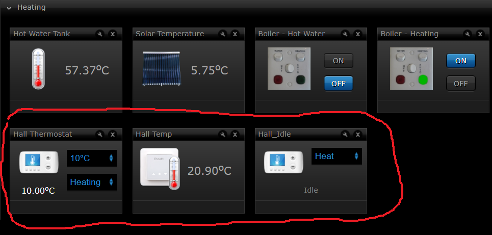

  1. I'm having problems trying to set up the Heating Panel and I could do with some help please. My setup- I have a Fibaro relay actuator that is used to turn my heating boiler on ready to accept a signal/call from the room (Heat-It) thermostat when heat is required. If I operate the Fibaro relay manually to turn on the boiler and then set the room thermostat temperature manually the boiler fires up and heats the room okay. When I installed the Heat-It Z-Wave thermostat it shows in the room as three devices as detailed below - I have tried to link the Heat-It thermostat (in the linked devices panel) to the Fibaro boiler relay but I don't see the Hall Thermostat in the Linked Devices list, I only see the Hall Temp and the Fibaro boiler relay. I need to be able to set/change the Heat-It thermostat temperature, hence I think I need to link the Hall Thermostat? Can anyone help please? Fibaro HC2 OS is version 4.151 Beta Thanks Steve
