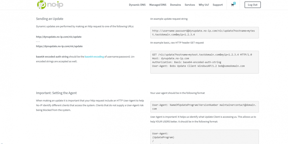

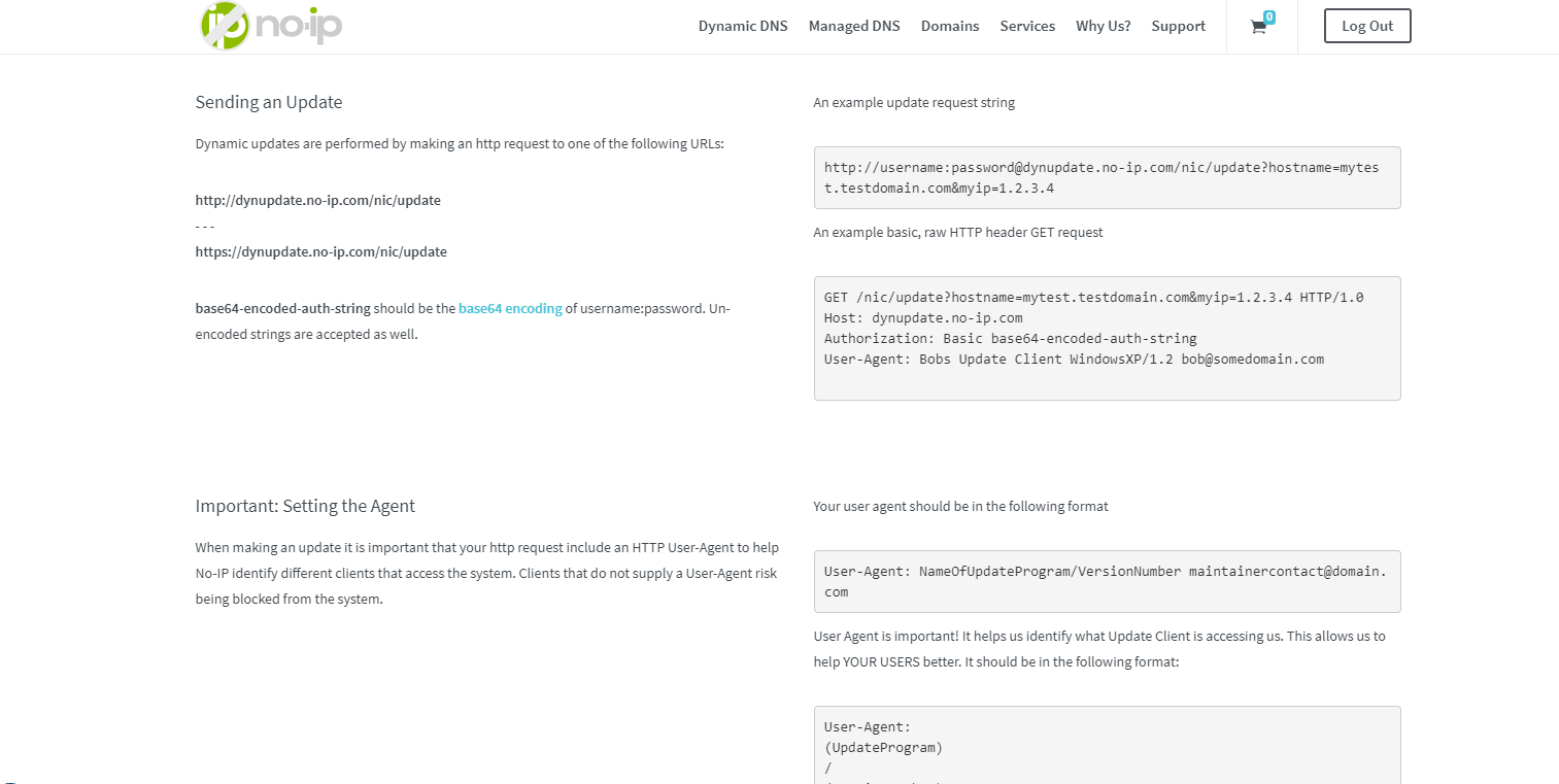

  1. Hi bros, i am newbie! I use NoIP DDNS Service to remote control my HC2 system, but sometime, the router update wrong ip to my NoIP host, so i want to create a Virtual device, which update my public IP every 6 hours. I found update api from NoIP service (which i attached), but i do not know how to request to a website via lua code. Could you please suggest me a little bit, thank you for your time! update1: I tried with the follow lua code: HC2 = Net.FHttp("myNoIPuser:[email protected]","80"); api = "/nic/update?hostname=mytestHostname.ddns.net"; response ,status, errorCode = HC2:GET(api); fibaro:debug('response: '); fibaro:debug(response); fibaro:debug('status: '); fibaro:debug(status); fibaro:debug('error: '); fibaro:debug(errorCode); and another button with string to send: GET /nic/update?hostname=mytestHostname.ddns.net HTTP/1.0 Host: dynupdate.no-ip.com Authorization: Basic cXVvY2hhZmliYXJvQGdtYWlsLmNvbdasTpxdWFuZ2todW9uMDFn and they do not work.
