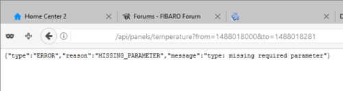

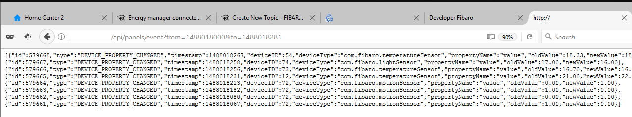

  1. Hello all, Has anyone tried to get the temperature data out from the home center 2 using the REST API because I am struggling. I can get other panel details such as the events etc which is using same format as the temperature but I get a parameter error. I have tried various things from such as with date settings and without with no success In the developer guide (although seems incomplete) it has the following information in: Temperature panel URL: /api/panels/temperature Methods: GET Description: Returns Temperature panel data Response: ? Events panel URL: /api/panels/event IP/api/panels/event?from=xxx&to=yyy IP – Home Center IP address xxx – start date timestamp yyy – end date timestamp Methods: GET Description: Returns events history from defined time, device states, state changes, their old and new values, etc. Response: Gets an object containing events panel settings. Please find attached images of what I am trying to explain. Any ideas would be greatly appreciated. Thank you in advance. Trevor
