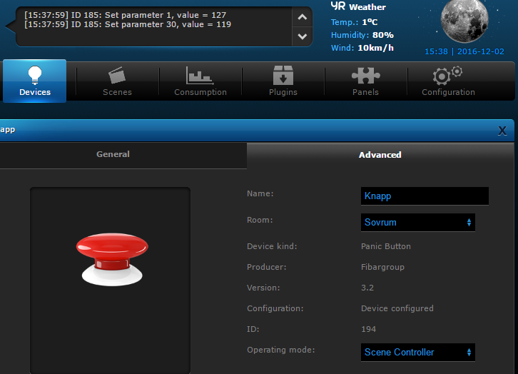

  1. I recently purchased a Fibaro Button and added it to the controller without problems. I moved it to the location where it should be and then it was out of range. I rebuilded the mesh network and let the button stay in it's location for a few days and was occasionally waking it up. It still didn't work, so I decided to do reconfiguration of the device. I tried that twice without getting it to work. Now the IDs on the device's page and the little log window on top of the HC2 page is displaying different IDs. See the attached file when I configure some parameters. When I have the button very close to the controller I can see that the Z-wave light on the controller flashes when I push the button but nothing happens. I have created a magic scene to switch a lamp to the opposite state when the button is pressed once. Nothing happens when the button is pressed. The light is possible to manage from the controller and scenes and so on, so nothing wrong there. I have tried to delete the device without success. I have also tried to force a delete from the HC2 and resetting the button. But still the z-wave light on the HC2 flashes and the device is still there. My HC2 is running 4.100 and the button is up to date according to the HC2. How should I get the button to work? Thank you in advance!
