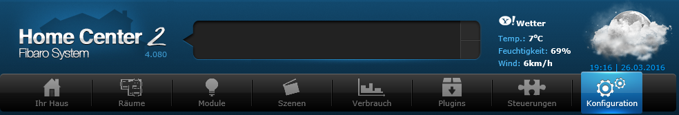

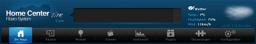

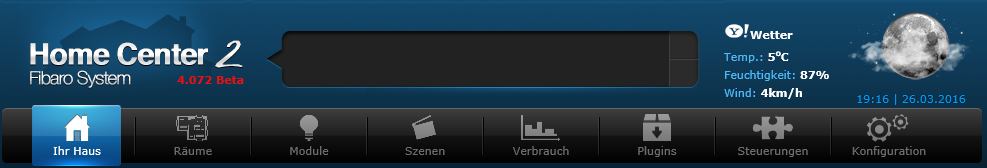

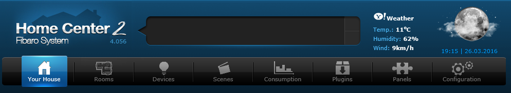

  1. Hi, for some reason since today morning the weather is not working for my city anymore at exact same time on 3 HC2s and 1 HCL completely different values: on HC2 with v4.056 Temp 11°C Hum. 62% Wind 9km/h on HC2 with v4.072 Beta Temp 5°C Hum. 87% Wind 4km/h on HC2 with v4.080 Temp 7°C Hum. 69% Wind 6km/h on HCL with v4.080 Temp 7°C Hum. 75% Wind 11km/h all of them have exact the same settings, i did changed them of course to test different location, rebooted, refreshed, etc. only two located in same network, the other two have different internet providers, routing, etc. all using proper DNS (8.8.8.8), of course tested with other DNS as well on all /api/devices/3 is showing the displayed data (so no cache, memory, etc. issue) ... and of course data of none of them is what yahoo weather is showing :\
