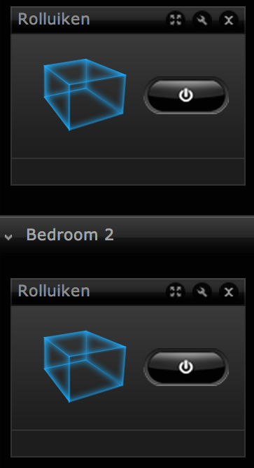

See some screens

Does anyone know, is there a way in Fibaro to show all buttons instead of just this power button? i would like to see all 3.
Guest Hakanos
You have to configure a three button and click main
When you choose three buttons, it still only shows 1 button on the devices/Your house page
/emoticons/default_sad.png" alt=":(" srcset="https://forum.fibaro.com/uploads/emoticons/[email protected] 2x" width="20" height="20" />
If you click on the icon with the four arrows you will see all the buttons.
Yes i get that but that is ..... stupid, why not show all buttons instantly without having to click on another icon first.
