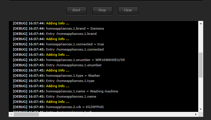

    an early sneak view of Bosch/Siemens Home Connect bridge for Fibaro.... Basic Bridge Scene function is ready. That is just the top of iceberg!
    So owners of Home Connect, you have fibaro compatible devices :)

    I like to share this work, hoping someone to get involved and complete the interaction with Bosch/Siemens Home Connect ecosystem. Till now code can read all the appliances that are under your account. It is required to build VD and inject all these data! (Work in progress)
    Cheers!
    B.S.H.C. Ecosystem Scene
    Steps to use this:
    **  Create a developer account on:
     by using the email that your ***real*** appliances are registered to Home Connect app.
    **  Create a new Application using OAuth Flow: Device Flow
    ** Input the email you registered your appliances
    on Home Connect User Account for Testing
    ** Change/keep the TableNameVar as scene will create with this name,
    a new variable table and save all data of BSHC Ecosystem
    ** Run this Scene on Advanced Tab
    ** Press the link to Authenticate HC2 on Home Connect account

    @pnutp0wer still there is no VD. on the previous post, there is only the scene that perform authorization, grab some basic data from devices (device name, type, etc). it is a huge load for all appliances that support home connect. So the posted scene is like a mainframe for build your own any VD that you like and hopefully contribute to community.
