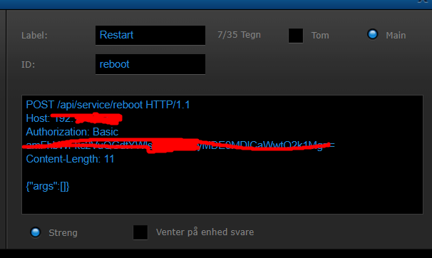

HCL Restart Version 4.110
GET /api/service/reboot HTTP/1.1
Host: 192.168.88.9
Authorization: Basic Login:Password (code base64)
0x0D0x0A0x0D0x0A

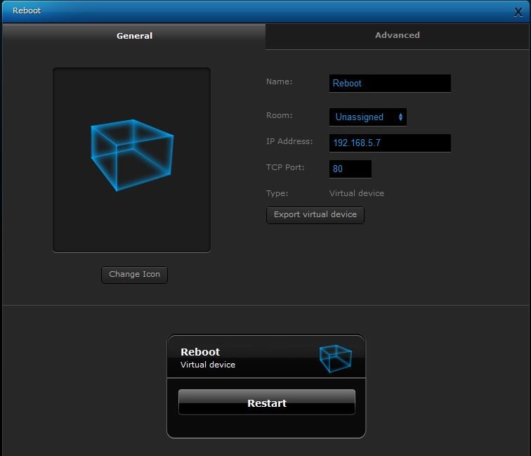

- I use firmware 4.110 but I am not sure if it is also set at port 11111. When I type in the HCL Ip address:80 in my browser, I get the usual login screen. when I use IP:11111 I get a blank screen. How can I make sure I use the correct port?
- Could someone share a screenshot of (a working) virtual device in firmware 4.110. This would help to double-check what I do wrong
Thanks!
1. use the same ID (SuperUser) & its password you can find in Configuration > Access Control
2. in the virtual device, there is a General tab where you give a name to it, assign it to a room, input your Fibaro IP then set the TCP Port:

I don't have that firmware but I read in another topic that the http command has changed from:
POST /api/settings/reboot HTTP/1.1
to:
I don't know if it is true but in case yes it would be the Nth mistake by Fibaro to make such a change and not highly distribute the information.
Just try it and see
API has changed from version 4.110. now it has to be GET
not only...also from "settings" to "service"
a total chaos
