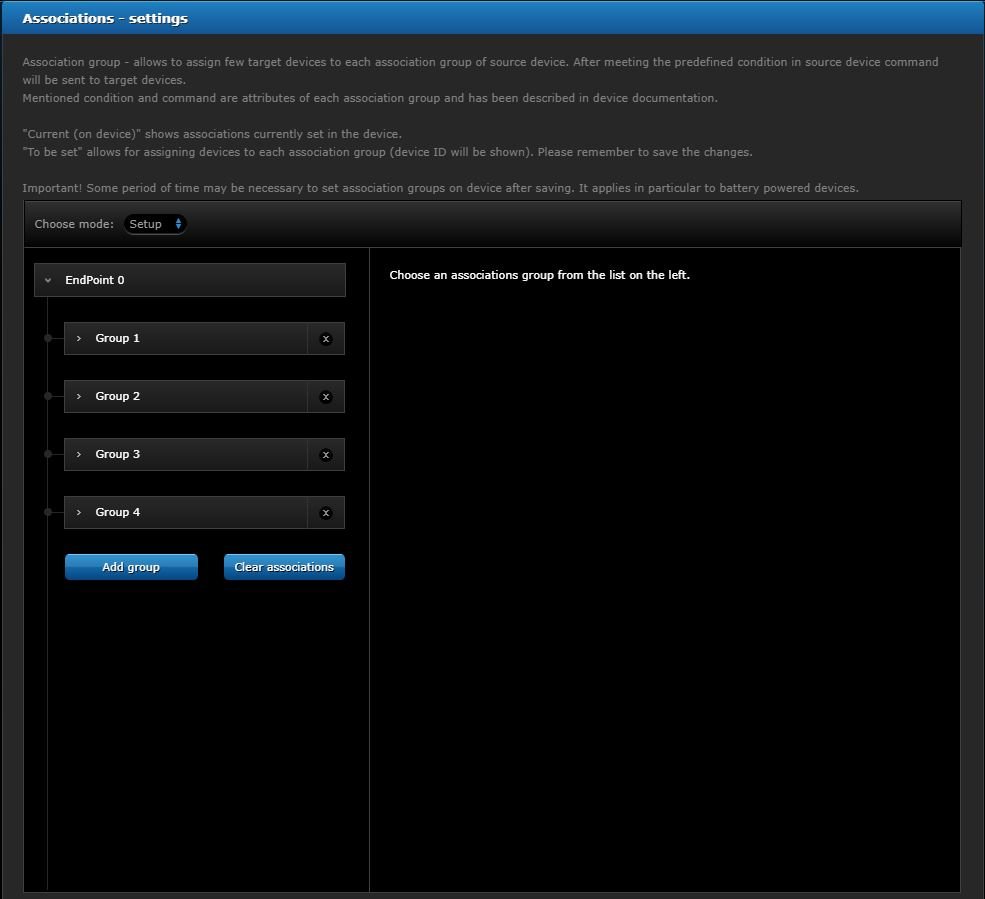

    • Select
       from the top menu
    • find your FIBARO Motion SensorMotion-Sensor
    • Go to the device settings by clicking the icon klucz_grey_kolko
    • Click on the Advanced tab, now scroll down and find Associations section and click Setting-Association button.
    • Find "Group 1" under "Endpoint 0" and click it.
    • Find your Dimmer 2 (under the name you have made for it) on the list and tick it in the S column.
    • Scroll down and click the Save2 button at the bottom of the screen.
    • On your Motion Sensor, press the B-button fast 3 times to wake up and send new configuration. Do this as close as you can to your HC2 unit.
    • When movement is triggered, your light will turn on now.
    • After some time without any movement in the room, the light will be turned off.
    • Change the timer: go back to Advanced tab,  scroll down to section  Parameters. Find the Parameter 6 to set the time in seconds. The motion alarm will be cancelled in the controller and associated devices after the time specified in this parameter.
      Each motion detected when Fibaro Motion Sensor is in sustain mode extends that time and restarts the counter. For small values, especially less than 10 seconds, parameter 2 should be adjusted ("Blind Time" of the PIR sensor).
    Hope this helps others with the same issue :-)

    • Select
       from the top menu
       button.
