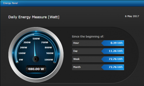

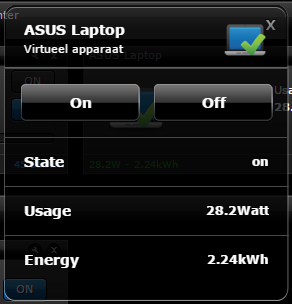

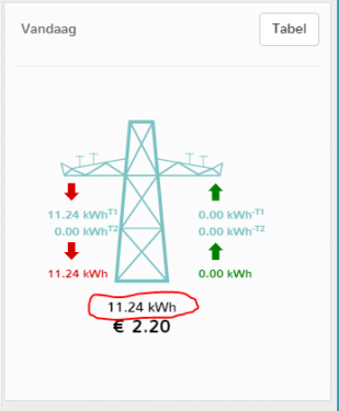

Actual status of the VD Please login or register to see this code. Please login or register to see this attachment. Please login or register to see this attachment.

Version 1.3. Added: Total energy usages from the Smart Meter, minus the energy values from all z-wave devices with power metering, to get the total of the remaining non measured power consumption
