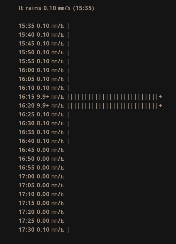

All, (draft note) I think I got it working again (very beta code) , it is a combination of old buienradar (thanks to Please login or register to see this link. !) and the code from 196a0f6808e4a6b6
Twannie

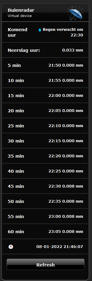

Thanks @Remi Here is the latest version I am running myself (Beta 1.3) Please login or register to see this attachment. Please login or register to see this attachment. c16956a3093b3f0103e58c
boerremk
Hi @Patrick, Yep the url is changed AND https, so I have to make a scene to get it working again.
