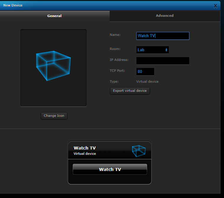

    To make a simple VD with one button that operates a blind ...
    1. In devices, click Add Device and select "Add Virtual Device" and switch to the advanced tab
    2. Name your device and allocate to a room of your choice
    3. Tick the check box against one button and click Add
    4. Name the Button e.g. Label set to "Watch TV"
    5. Click the LUA code tickbox and replace the "string to send" with fibaro:startScene(567,{"All Open"})  ... 567 may be different in your system.  It is the scene ID of the scene we just created above.  "All Open" is a scene I have defined that does what it says on the tin!
    6. Click Save on the right-hand side vertical menu bar.
    7. Test it
    Files attached here  a) this very simple VD called Watch TV and b) a lua (text) file with the scene code.
    Have fun.
