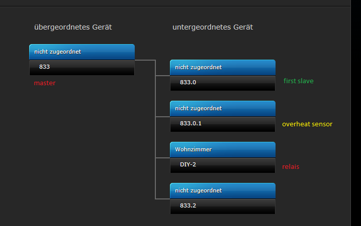

    Note: the 834 in my example is the first slave, not the master nor the relay(s) itself
    (here for SingleSwitch2 FGS-213
    -master 833 -> ID833,
    -first slave 833.0 -> ID834,
    -overheat sensor 833.0.1 -> ID835,
    -Q1 relay 833.1 ->ID836 renamed already to DIY-2
    -second slave?, anyway, 833.2 -> ID837)
