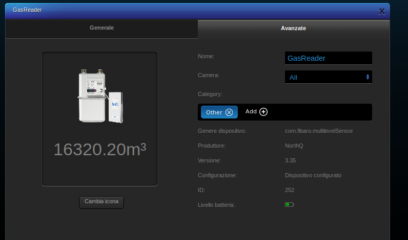

    Hi Marbe.
    Could you help me to configure this device... I have included the gas reader but it doesn't update the gas consumption.
    Which parameter do you have configured?
    I have set:
    pulse factor to 10000
    sensor type silver pot
    wakeup interval 15min
    pulse count set to initial value 16317030 (it is shown 16317.03 m3)
    keep alive period 30min
    Thank you for helping me .
    MArco

    Thank you for your answer...
    I have a silver pot I have set the reader as the image...
    /monthly_2019_02/image1.jpeg.ddbb187f51bd5e805f20c0efd6acaa27.jpeg" alt="image1.jpeg.ddbb187f51bd5e805f20c0efd6acaa27.jpeg" />
    I this case what do you think is pulse factor? I have tried whit 1000 and 10000 but the value not update... I'm getting crazy because I have the reader more than six month and It hasn't been configured :-(
    The sinc whit HC2 is ok because every change I made after 15 min the device is updated.
    But the consumption is not updated...
    thank you
    marco
