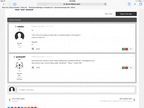

that code works for emailing a photo to your phone but i wanted to inbed the photo the notification but doesn't seem all that possible :(

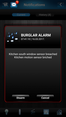

    I just try to see if I can send camera picture to popup message instead of icon and this is result:
    EDIT: I just replaced picture with one made during day :-)
    It is not really useful since picture is small but if you want to try all you have to do is to put path to camera jpeg. This one is for my Foscam camera:

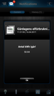

    Today at 08:15 a popup came with yesterdays total energy consumption.
    Now i can stop using notify my Android from my old system :)
