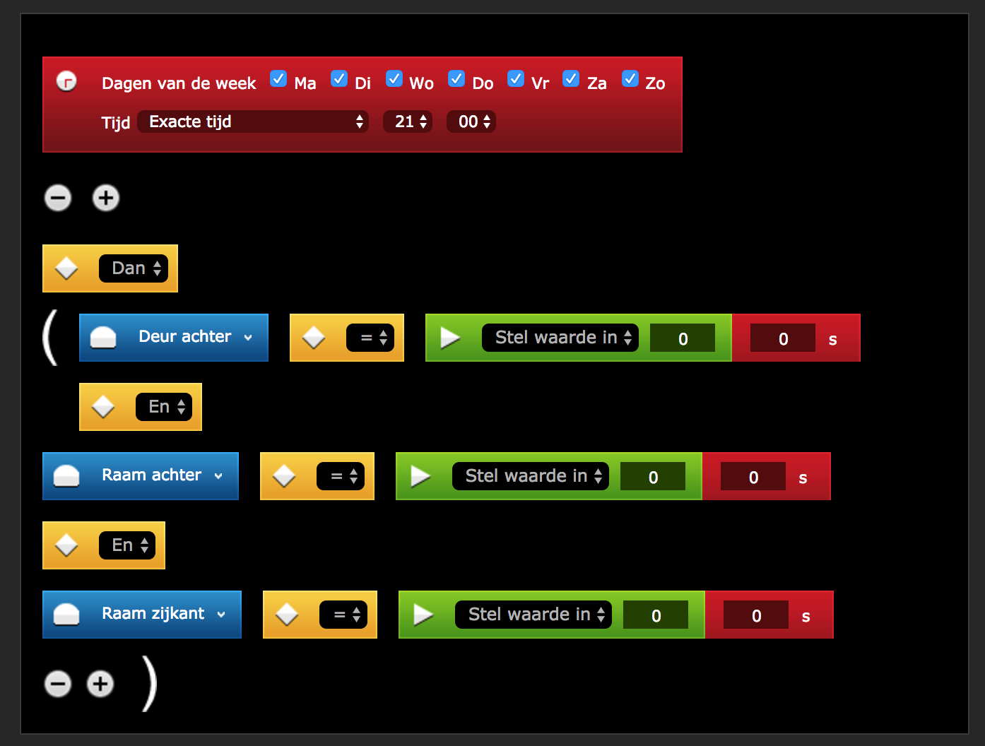

I did create a block scene, but it is not working as expected. When I press the 'PLAY' button on the scene, it looks like the scene is triggered, but then nothing happens. What is going wrong here?
When I close the roller shutters by the device itself, it works great.
edit: I just did change the setting on the 'DEUR ACHTER' roller shutter to = CLOSE instead of 'STEL WAARDE IN = 0'. The other two roller shutters remain as before in the scene. After saving the scene and manually running it by the PLAY button all the 3 roller shutters close as is ment. How can this happen?
@bowsertjeWhen using the first option "Stel waddrde in 0" dont you have to give a pecentage ie not =0 but =99 for closed =50 for half closed etc

    So instead of 'Open' you are not allow to choose any other option instead?
    Yes, but in this case i wanted to close them. Normally it works also when choosing ''stel waarde in = 0''. But something is does not. Looks like a bug somewhere in my scene?

    @bowsertje no open is all good but your first screen shot showed the green box with the extra box to the right with the "0"
    thats a value box, so if there is no value in it it wont do anything.
    Does that make sence?
    Ok sorry I see what you mean
    what if you put "1" as the value, does it close 99%?
    Edited by Jamie mccrostie
    Hmm, I don't get it. In my first screenshot the extra box with ''0'' is already there?
    Correct
    @bowsertje did it use to close with a "0" as the  value?
    @bowsertjeOk i just reread your edit, I think I get what you were saying
    So you mean the scene wasnt working, you changed one commmand from "0' to "closed" and left the other two commands  as "0' and then the scene worked as it should.
    Ive found with block scenes that sometimes they just stop working ...
    if you delete them and re do exactly the same scene  they work again.
    Yes it did! But it works not stable.
    Yes, that is exactly what is going on. How can I prevent this to happen?
    Thats block scenes, mostly they work ok untill something in system changes . In the same way scenes copy function often doesnt work  if you convert them both to LUA they are identical but one doesnt work
    I dont think there is a fix
