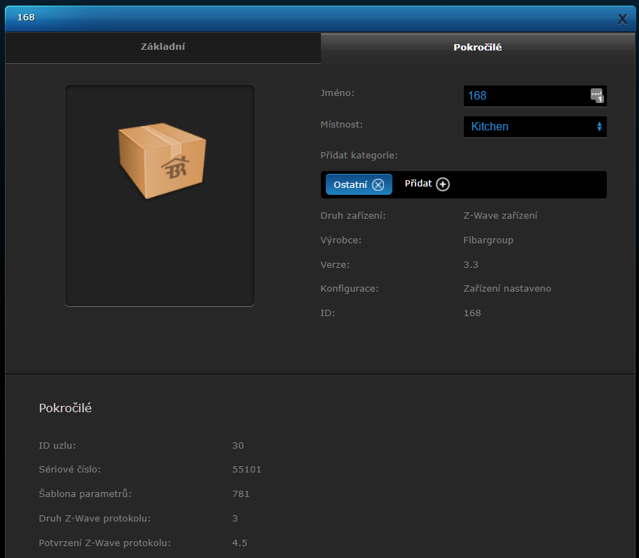

    Problematic switch info:

    Have you checked the first endpoint for the button? Have a check in the advanced that tab of that endpoint.
    /monthly_2019_08/image.png.ef2c2324f884e3bfecad3d9bb827f12f.png" />
