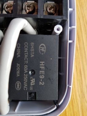

    That is not recommend either. Your contacts will weld (stick). Use a big, secondary relay between the Z-Wave module and the load (supply, air conditioner, pump, ...). Sorry, no power measurement...
    Aeon makes a "heavy duty" relay but I doubt it meets your requirements, I have to look it up. Nominal current is not the only issue, it is peak current and arcing due to inductive kickback that kills small relays...
