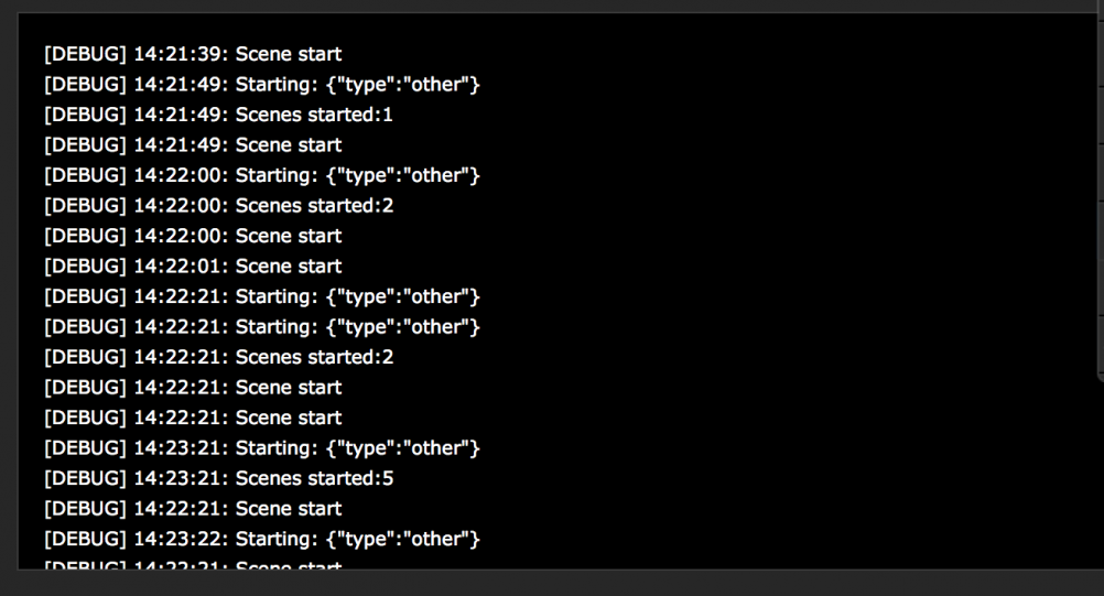

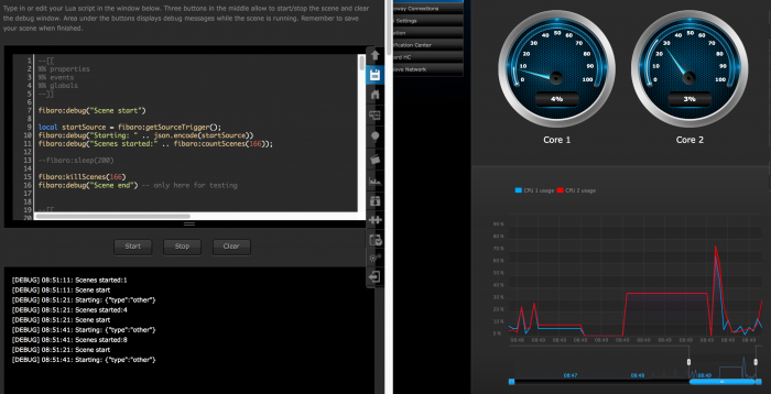

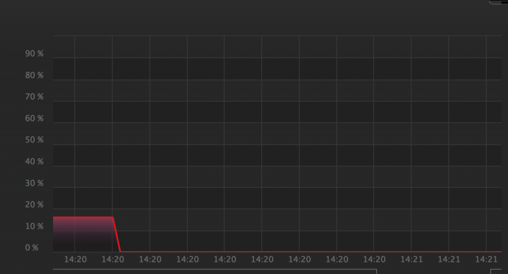

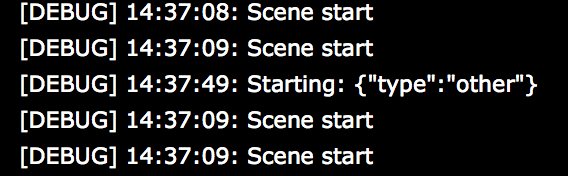

same error (sporadic), v4.144, very simple scene on empty HC2, so must be something generic:
Edited by tinman
What happens if you use sleep instead of setTimeout? This is a long shot: maybe it is the combination of setTimeout and killOtherInstances. I base this on an observation of some unexpected behaviour of one of my scenes. I do not post code, because I still have to investigate... It might be a programming error (due to insufficient cafeine).
that was my thought as well, but no, here simplified scene, and i can click as much i will, no error as it is very random / sporadic.
@tinman thanks. Maybe it is a kind of race bug, or some locking/multithread issue. Mabe it depends on what other stuff is going on. CPU memory pressure? Just thinking out loud. Tough problem! Sorry, I ran out of ideas. On a PC I would set a flag, to let the OS think it runs on one CPU only.
