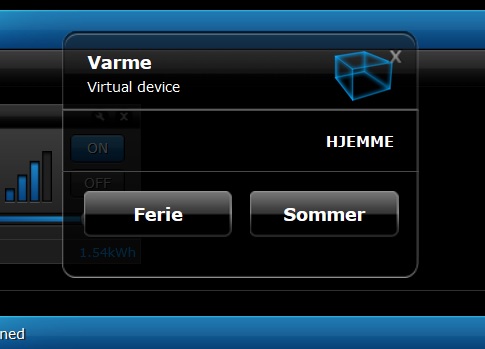

Another question:
Now I have this symbol
How can I make it like this and to make it shown in the system(APP)
/monthly_2017_11/5a1dcc25a500f_utennavn2.jpg.0735fc5c4d71dbf3c2d5628d5551ecb7.jpg" alt="5a1dcc25a500f_utennavn2.jpg.0735fc5c4d71dbf3c2d5628d5551ecb7.jpg" />
I really would have appreciated any help in this matter, :)

    Maybe you have an answer for this as well..
    In Fibaro Home screen the virtual device is shown this way:
    Is it possible to have it like this, so I easier can change status.
    Thanks,
