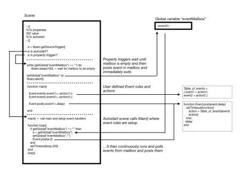

  • (we are diverging from the event proxy now but I have an idea how to merge the EventProxy with the EventModel...)
    So, the
    Please login or register to see this link.
    I use to code my scenes in nowadays do solve the synchronization pretty ok (for 6+ month). I have a producer/consumer pattern with a shared variable that has not given me any race conditions under stress test - which seems to imply that read/write to a global is kind of atomic... Having that, it is possible to implement a synchronized mailbox between producer/consumer "threads" (see code below)
    People that use global variables to send parameter between scenes are in the risk zone to have race conditions because it is easy that the producer (sending scene) writes a variable twice before the consumer (the receiving scene) reads it. So that doesn't work. (Using startScene with args solves that somewhat because new instances are started of the receiving scene... but you get multiple instances... more on that later).
    The code below showcase how to get around it.
    In main() goes the scene specific code and below that the standard boilerplate Producer/Consumer code that runs the event model logic.
    -main() gets called from the "Consumer part"'s setTimout thread with incoming triggers and events, and main() can keep a state in variables outside main() or in closures.
    -It gives an example of a timer to turn off light with the variable "timer" keeping the state of the timer.
    -Another example triggers on incoming changes to a global variable "counter" and keeps it own state in a variable "counter2"
    The last example is interesting because if you from another scene run
    Please login or register to see this code.
    You see that the scene gets all the events but it will always read "10" as the values are overwritten before we can read them (however, the local counter is updated). Very quick triggering as in this case will create new parallel instances and you thus need  set max instances to 10 in this case. More than 10 quick invocations and you will loose events - but that you will do with an ordinary scene anyway. Just a small delay after setGlobal will make the receiving scene keep up because the Consumer is very quick to read events and re-post them (the delay of 250ms can be varied but it has worked well for me). The incoming "Producer" instances of the scene will in worst case buffer up (to max 10 instances) until the Consumer reads them so I guess that is your stack...

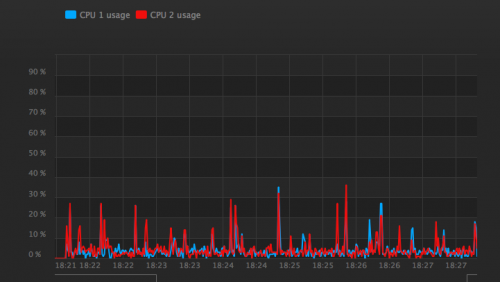

    The load (CPU) on the system is very low and smooth for me - I have 5-6 scenes running this model, some of them quite large, and also doing "inter-scene" communication with events (very little RAM too). The only busy wait is the "Producers" but they terminate on average very quickly and run only on incoming triggers/events anyway (can't see any difference between 2 or 6 scenes, and I believe the spikes are GC or housekeeping stuff...).
    Please login or register to see this attachment.
    This model, besides allowing me to keep local states in-between triggers invocations, have a lot of other advantages.
    -I can do some heavy initialisation in the code (like setting up home tables or other things) as it is only done once when the "main" scene starts
    -I can mix and match fibaro events with my own events and even send events between scenes that arrives as normal events to main(...)
    -- I can easily have "subroutine patterns" with return values (e.g.  ping/pong patterns for scenes to make sure that scenes are alive....)
    -I can easily post my own versions of fibaro's events to simulate and test the logic in the code
    -The post function allows for delayed post so I can set up triggers in the future...
    The big
    has a lot of other features for pattern matching events, flexible time format for posts, and some complex event processing (CEP, i.e. matching that not an event happens, or that events happens in a certain order), scripts, and various scheduler test (cron etc.)
    Edited by jgab
    Used an old version of the locking code
