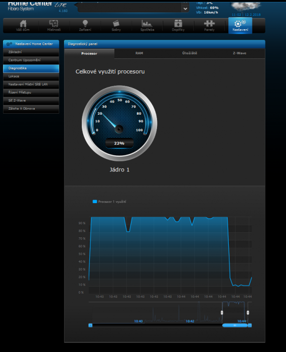

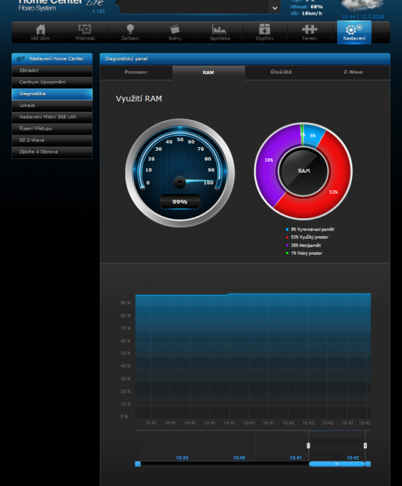

Today i update to 4.160 and after about one hour, freeze.. I did a hard reset and i wil give it a try, but i am sceptic because RAM usage is 97-99%.
Edit: Free RAM is now 6% :D
Edited by EirikT.
Same here. HCL freeze today.
    After hard reset, HCL uptime is now 6h30m. Tomorrow will show...

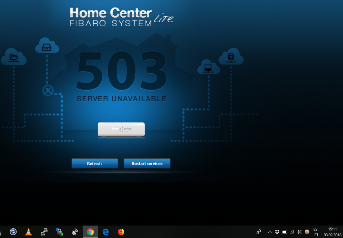

    503  :?
    After 24 hours again error 503. Now I'm really angry, this is not home automation. This is a fight to restart hcl. Fibaro team, instead of developing new products, you should be interested in a stable system !!!
