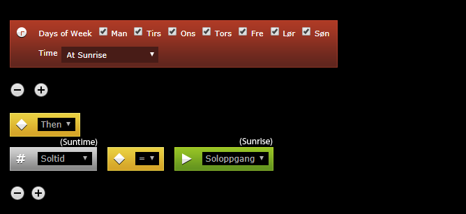

Setting sunrice:

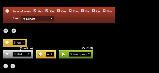

Setting sunset:

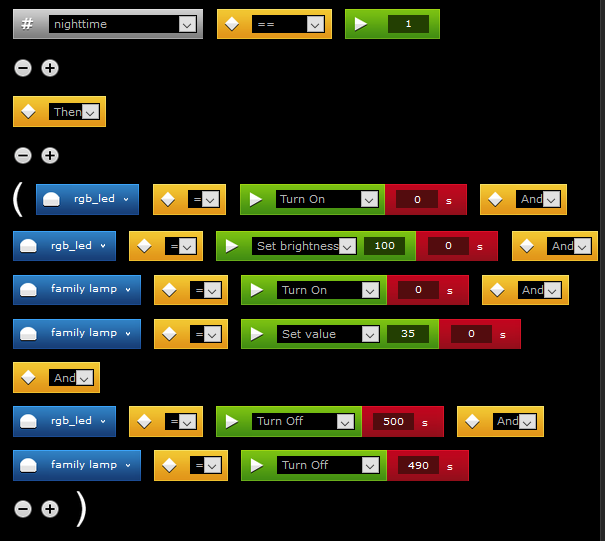

I Use similar conditionals for this nightlight scene but .. it lets me grab back door access, someone getting up from the couch, going to the toilet at night etc etc when the primary areas lights are off ..
/monthly_2018_02/image.png.58bc91852d254a927ba5dd2e5432320e.png" />

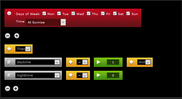

I suspect though that it is the conditonals in day/night .. mine looks like this .. so it turns one variable off then the next on :) ( Otherwise they are both night & day  and lights get confused )
Hope this helps !
