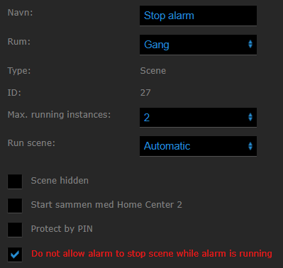

I have of course checked the box "Do not allow alarm to stop scene while alarm is running". It is the same with all actions in the alarm panel, all actions are taken AFTER alarm is disarmed. For example notifications that alarm is breached are sent after alarm is disarmed.. I have tried with rebuilt scenes, reconfigured devices, new notifications etc but al with the same result.

    Stop alarm:
    Lighting red lamp the house is not secured.
    The scene is running when you turn off the alarm.
    The scene also runs if you turn it off when it is triggered. (The siren is running).
    Stop alarm after 10 minutes:
    The alarm panel is running this scene.
