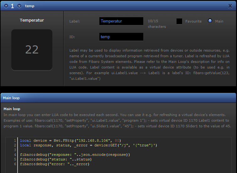

Hi @Teza,
Try this code:
local device = Net.FHttp("192.168.8.106", 80)
local response, status, _error = device:GET("/j", '{"true"}')
fibaro:debug("response: "..json.encode(response))
fibaro:debug("status: "..status)
fibaro:debug("error: ".._error)
If IP address and TCP ports are correct and also path "/j" then you should get answer in 'response'. If you get nothing then status and error should give you a clue what is wrong. If request is correct then status should be 200 and _error = 0

@robd Amazing, thank you very much!
By slightly changing the code to:
MyId = fibaro:getSelfId()
local PI1 = Net.FHttp("192.168.8.106", 80);
res, status, errorCode = PI1:GET("/j");
-- rootDir voor webservice is /var/www/html
fibaro:debug ("status "..status.."; errorCode ".. errorCode.."; res ".. res);
arrData = json.decode(res);
-- de te decoderen data moet wel in json format zijn anders krijg je een vreemde foutmelding
fibaro:debug ("SupplyAirTemp: ".. arrData.supplyAirTemp)
It now return the following in the debug window:
[DEBUG] 14:32:38: status 200; errorCode 0; res {"data":{ "id":"8200007A","type":"8","detector":"SI29BG","voltage":379,"cpm":24,"temperature":19.64,"humidity":45.75,"pressure":100902,"voc":11987133,"co2":505,"noise":43,"ch2o":0.02,"pm25":3,"uptime": 63678}}
[ERROR] 14:32:38: line 19: attempt to concatenate field 'supplyAirTemp' (a nil value)
This is a huge step forward for me.
I can now focus on how to be able to use these values in HC2.
Link to post
