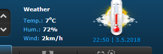

Hey @Fibaro
I am trying to ask again fix custom (own) Weather Provider
so, as you can see I can't choose own sensor
after investigation i found what according to a source file
\opt\fibaro\plugins\com.fibaro.WeatherProvider\WeatherProvider.lua
you grab only specific devices
so, is no chance to pick a multisensor device.here.
please fix it.
thank you!

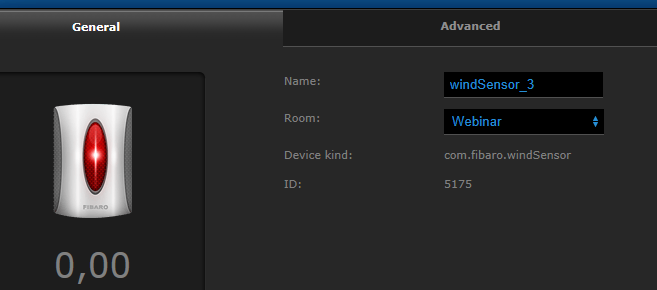

    Let's do a test if Fibaro know windSensor type, and add raw "com.fibaro.windSensor" device:
    yep, that is working, plugin can see it now:

    looks good, but the windSensor will still get mapped as multilevel and not wind sensor :(
    Now the interessting part is to understand why UI shows different type, so let's check the same template but this time downloaded with "Download device's template" button:
    the windSensor from template file got in the UI changed to multilevelsensor.
    That means Weather provider plugin is ok, Z-Weather template is ok, "raw" windSensor type is supported, but something is broken in the windSensor implementation.
    From what i see, windSensor is not fully implemented in UI (type is unknown in types table), it would be nice if Fibaro could fix that.
    For now, all "one can do", is to create virtual device  - and write value via scene to it (not VD), or have real device reporting as raw com.fibaro.windSensor,
    or to patch the database (did i said that?) by replacing (for that one device only) the com.fibaro.multilevelSensor by com.fibaro.windSensor in the NEW_Device table.
    After such patch, my Z-Weather wind sensor can be selected in the plugin and it does shows data coming ...
